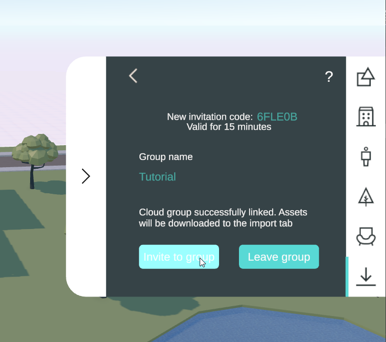

Link the cloud group to your Arkio devices

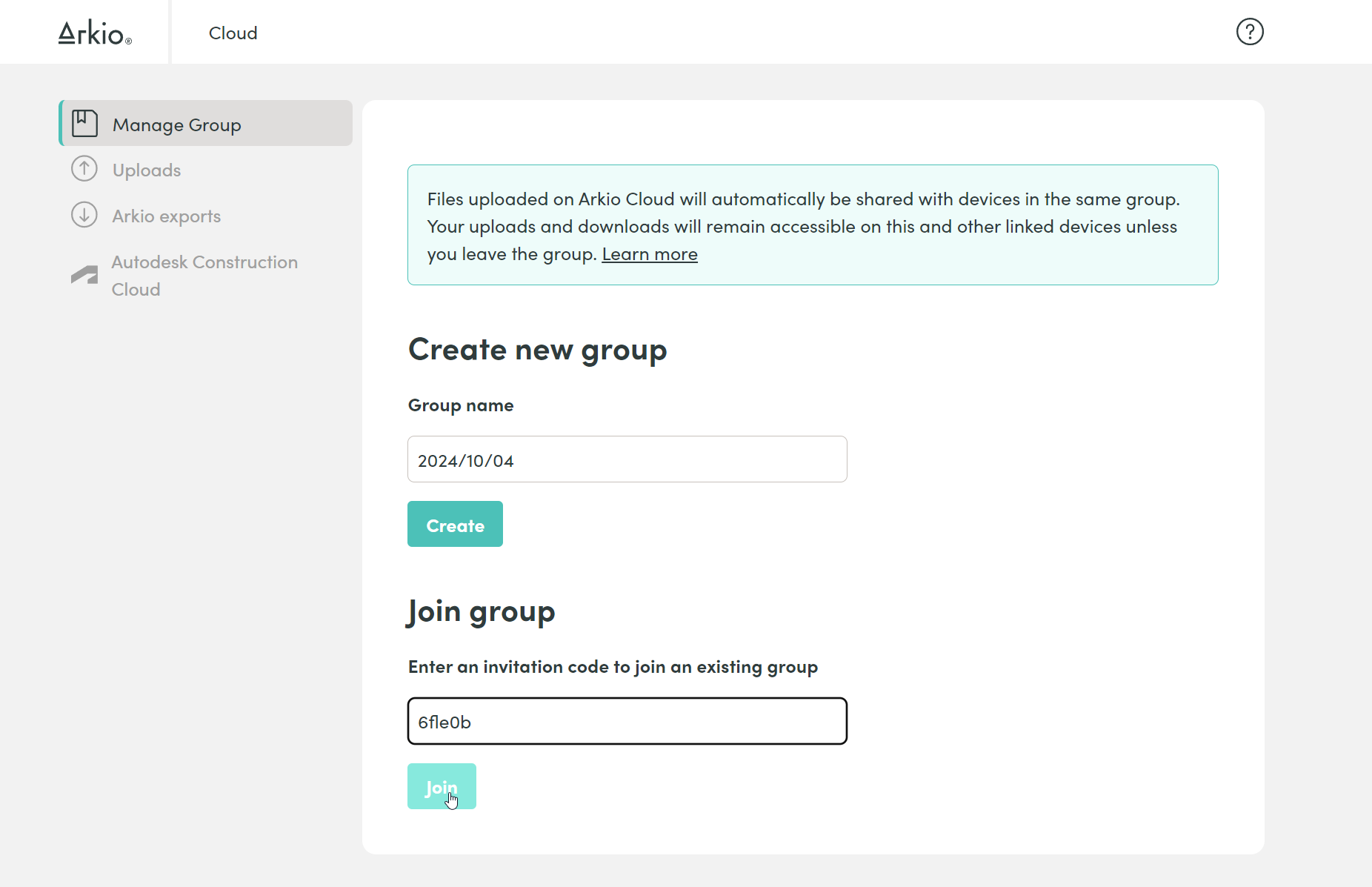

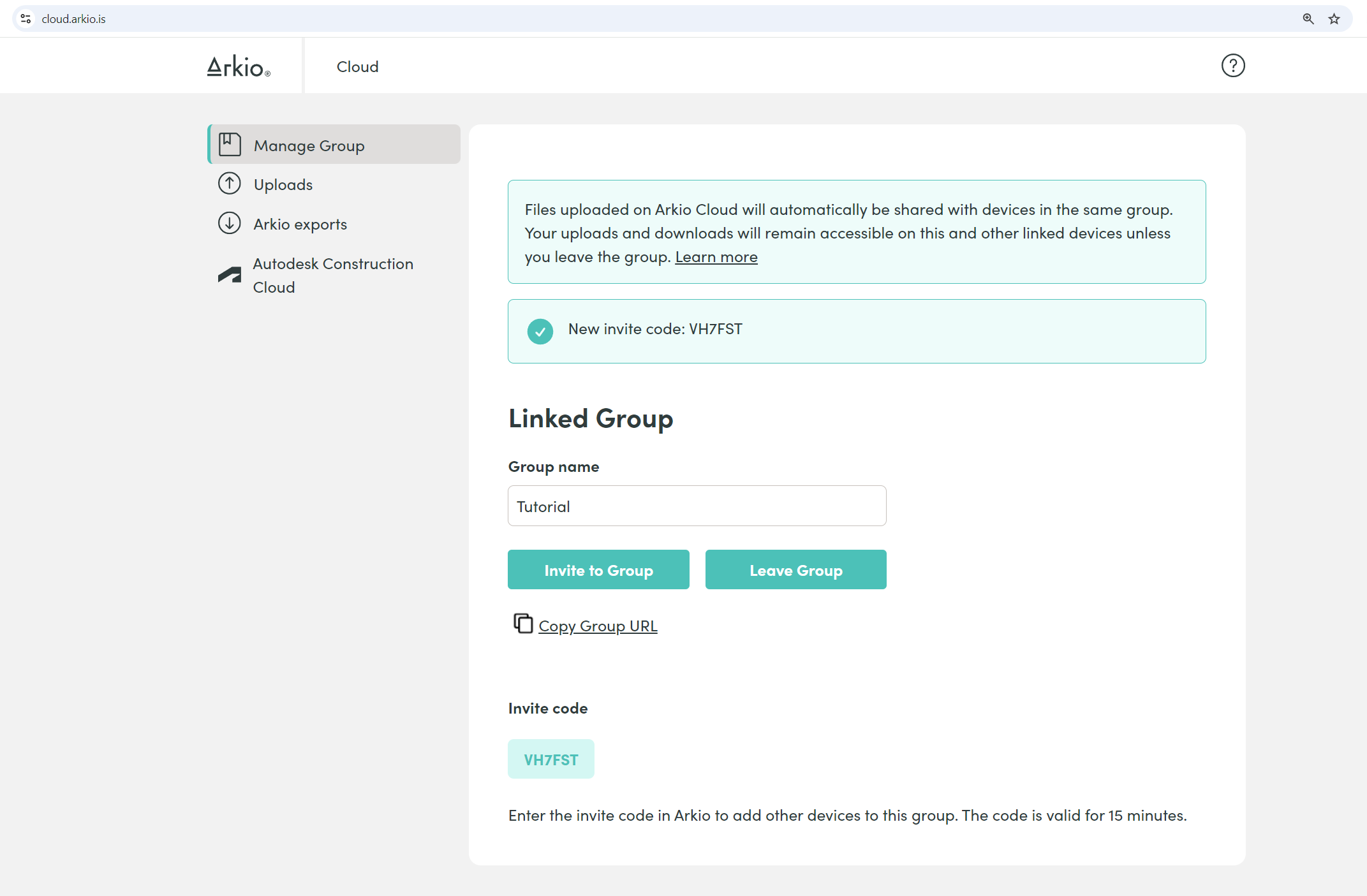

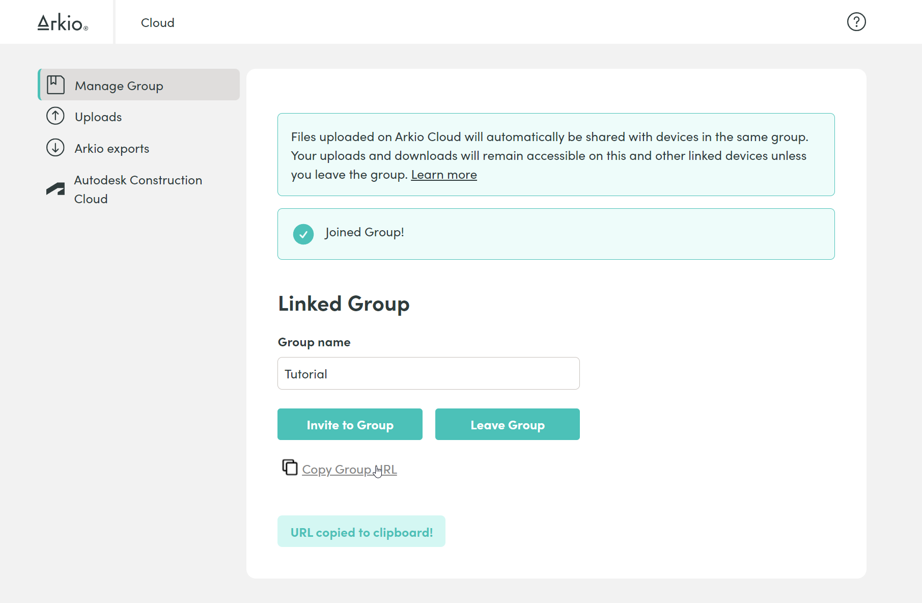

The Arkio cloud portal allows you to upload and download 3D models and images to and from Arkio on your devices. You can access the cloud portal at cloud.arkio.is to create a new group and optionally give it a name. Once your group has been created you can join the same group in Arkio on your device by entering the invite code provided on the cloud portal. If your original invite code has expired, simply create a new one.
Note: The Arkio Cloud does not require a license, user account, or email. You can create, join or leave Arkio cloud groups when needed. Only the Arkio app requires a license to place larger models in the scene.

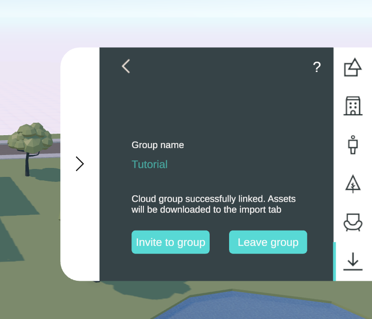

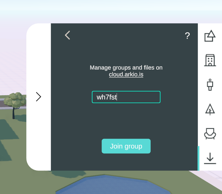

In Arkio you can join the group by selecting the create tool, opening the cloud panel, and entering the invite code here. When joined, any files uploaded through the cloud portal will automatically be downloaded to Arkio.
If you join the same group on multiple devices, the files will be downloaded on all of them. Files transferred via the cloud will expire on the cloud after 7 days.

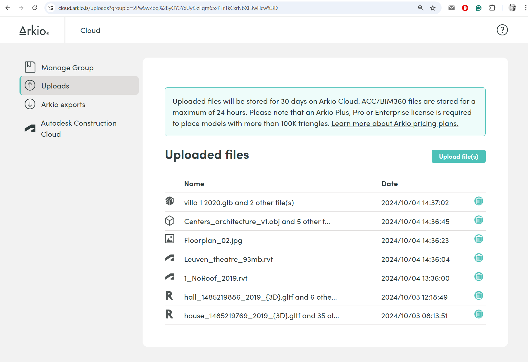

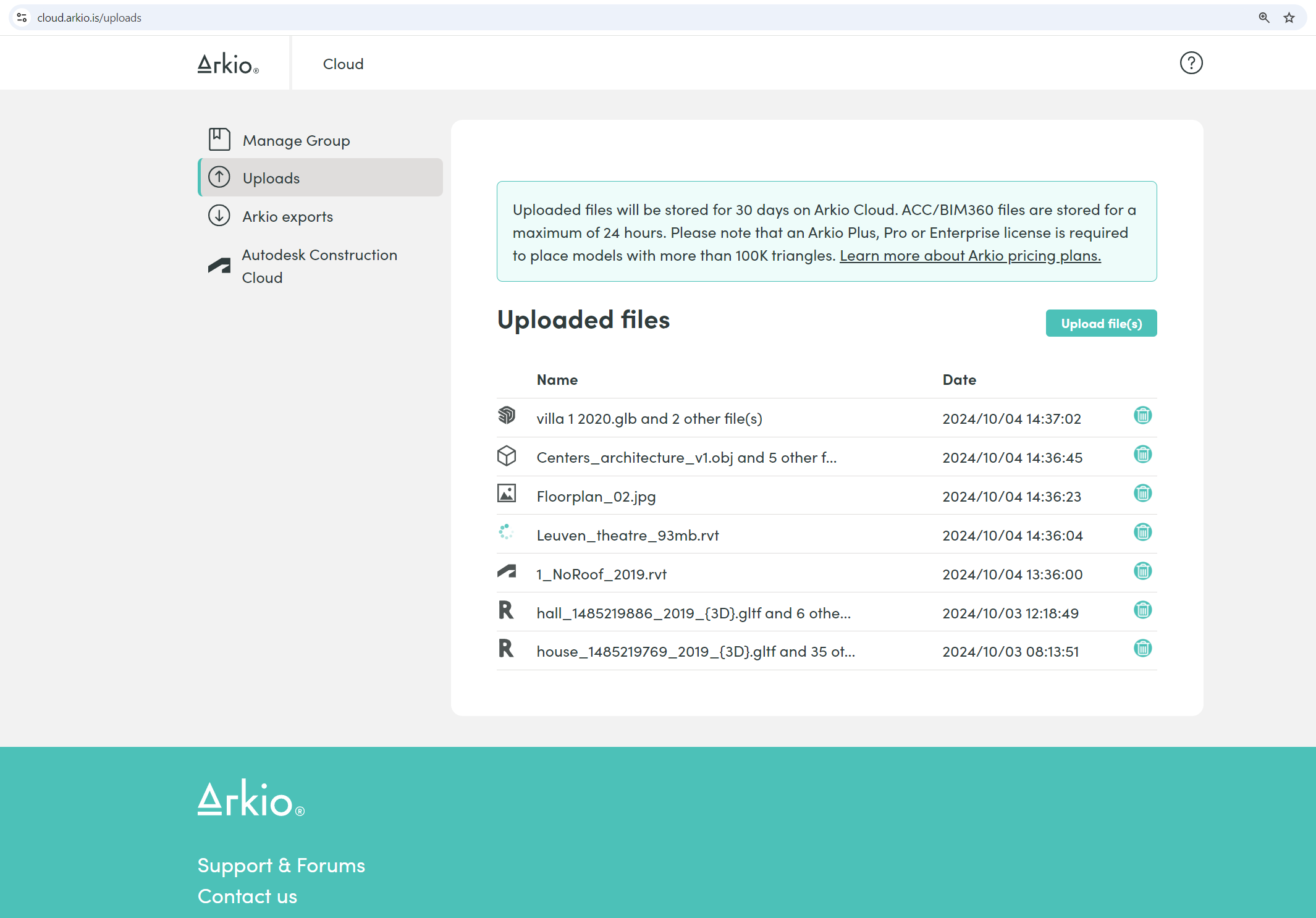

The Arkio cloud portal supports uploading of images, OBJ and GLB models as well as exports from the Arkio plugins for Revit, Rhino, SketchUp and Unity. Exports from our plugins can be found under \Documents\Arkio\Import\. You can multi-select and upload files that belong to the same 3D model or zip the files to upload them as one file to your cloud group.

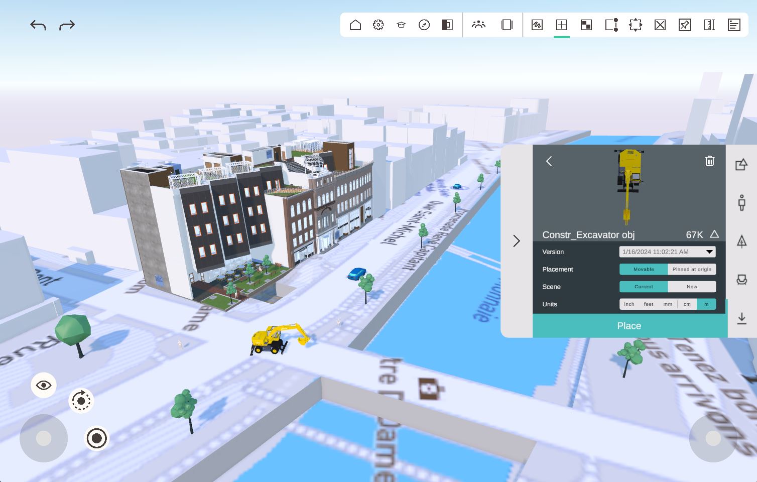

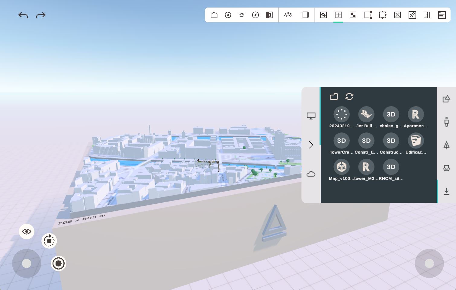

Once your files are uploaded to the Arkio cloud and your devices are in the same Cloud group the files will automatically be downloaded and processed in Arkio, the assets will appear in your import drawer and can be placed in the scene locked at the origin or placed as an object.
Note: Placing exports larger than 15 MB or models exported from our Unity, Revit, Rhino and SketchUp plugins will require a paid license to be applied in Arkio.
Imported models and images can be locked as a non-movable reference (Locked at origin)
or placed freely like other Arkio props (Place as object)

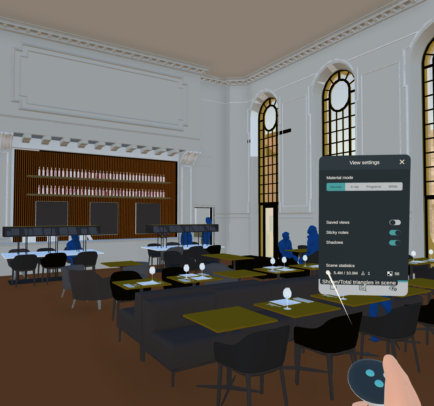

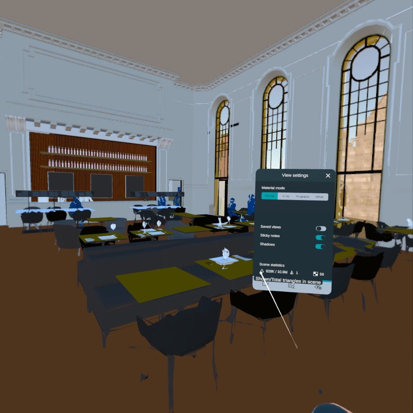

The Quest and smartphones are mobile devices running on a battery with limited power. You want to make sure that imported models don't exceed 450K polygons to avoid crashes or uncomfortable framerates for your VR experience. If you have a heavy model but still like to load it on mobile devices you can hide parts of the model in the view before exporting, use lower LOD settings on our plugins or manually optimize your models for mobile devices. We limit the maxumum
Platform | Max. polygons | Max. file size |
Windows or Mac | 20M | 2.000 MB |
Meta Quest 1 | 900K | 180 MB |
Meta Quest 2 | 1,5M | 250 MB |
Meta Quest Pro | 1,5M | 250 MB |
iOS | 1,5M | 250 MB |
Android | 1,5M | 250 MB |
