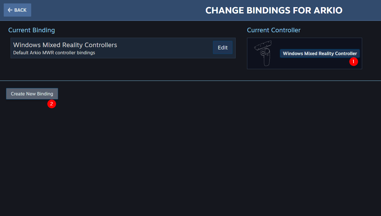

To get started you open the controller binding menu following the first step in the Oculus Guide. Then you select the correct controller you like to edit from the "current controller" list and create a new binding.
