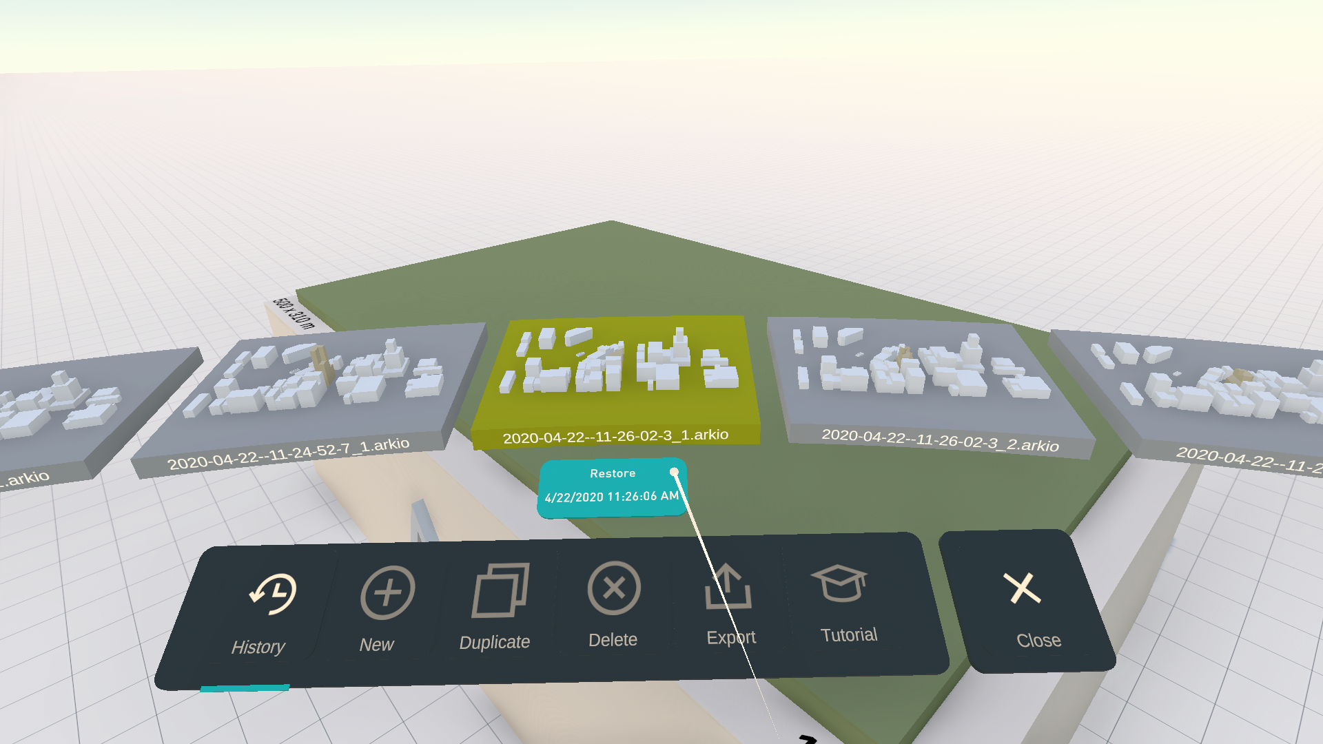

When you have faulty geometry in your Arkio scene showing spikey geometry or a red scene plate or if you missing a scene. You can use Arkio's history mode in the scene viewer to find a recent backup on your device. Backups of scenes can be found in Documents\Arkio\UserModelsHistory and are made every 2 minutes so a healthy version of your scene can often be found back.
The steps to restore your scene are
1) Click the history mode and navigate to the model/time that looks correct
2) Click restore to bring back the selected yellow platform to your main Arkio scenes
3) Inspect the restored scene to see if it contains all the latest geometry
4) Repeat the steps to find and restore the most suitable scene
