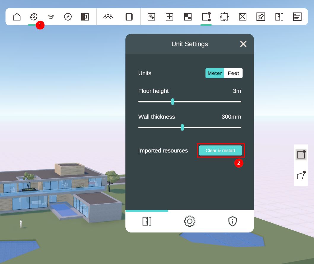

Temp resource files
If you experience problems with your imported/downloaded content like files not loading or your list of imported files showing weird behavior you can clear your temporary resource cache. On the next startup, Arkio will then re-process all source images and 3D models in your \Documents\Arkio\Import folder and redownload any models and images that have been shared with you in an Arkio meeting or scene.
It's also possible to manually remove these resource files from your device by clearing the files from the device paths at the bottom of this page.

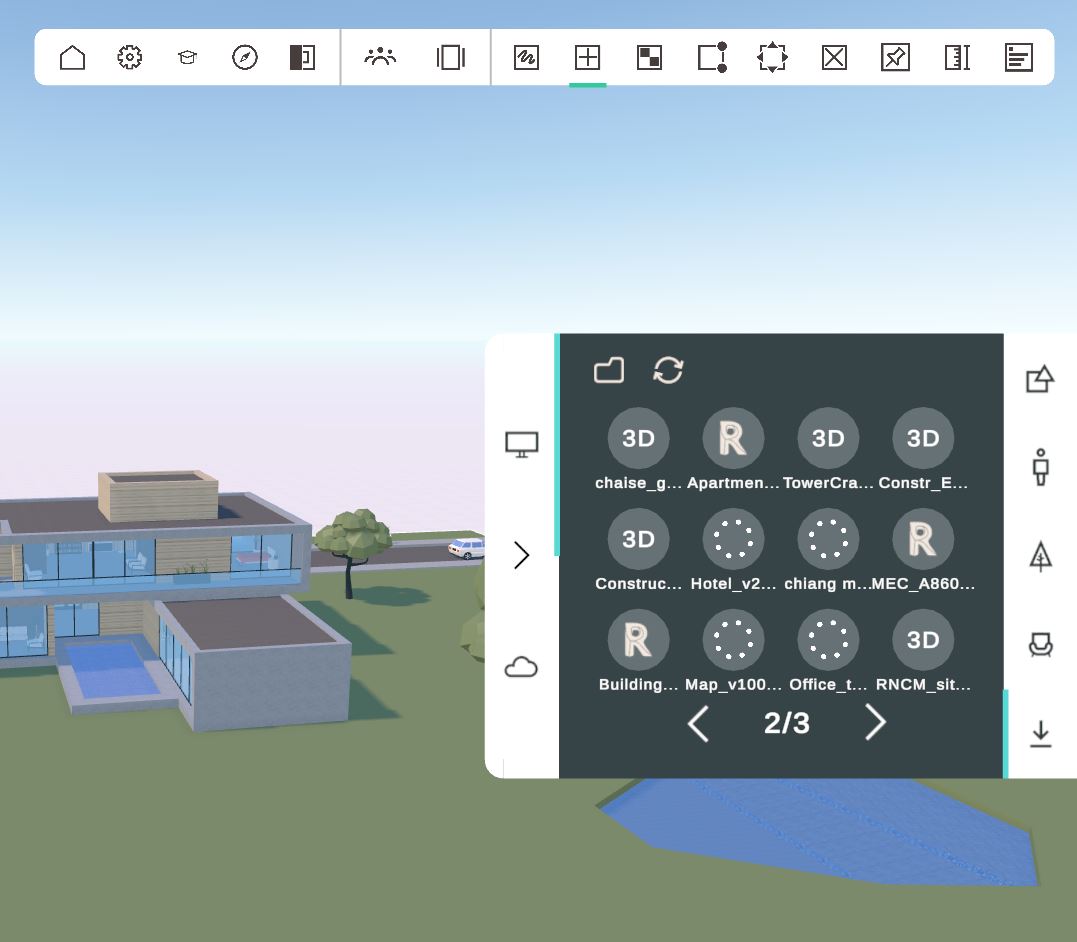

Import source files
Source files placed in the Documents\Arkio\Import folder will be reprocessed when a new file is added. If your import files are causing issues you can best also remove the the source file from the import folder that is causing issues as those files will be reimported every time you clear the resources cache.
Deleting a source file from Documents\Arkio\Import will not delete your imported files from Arkio as these files are often already processed to Arkio resources in the ResourceCache folder. If you wish to delete a resource completely from Arkio a manual deletion.
Cloud group imported files can also be downloaded in these import folders so when having issues with your imported files and preventing redownloading the source files you can best leave your Arkio cloud groups and join a new group instead.
