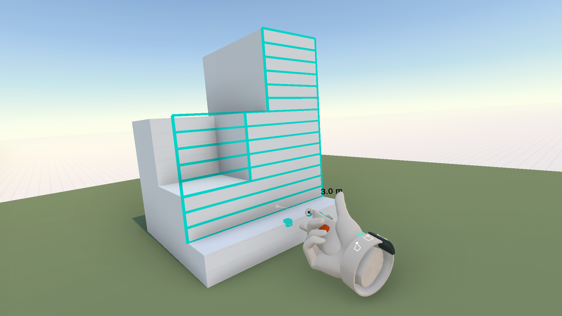

    Creating a stacked volume with fixed floor-to-floor height (or a hollow shell shape) is only possible when creating a new volume.
    You can cut an existing simple volume into a stacked shape by using the split tool but this gives you less control over the floor-to-floor distance than re-creating a shape which is often also faster than adjusting already created geometry in Arkio.
