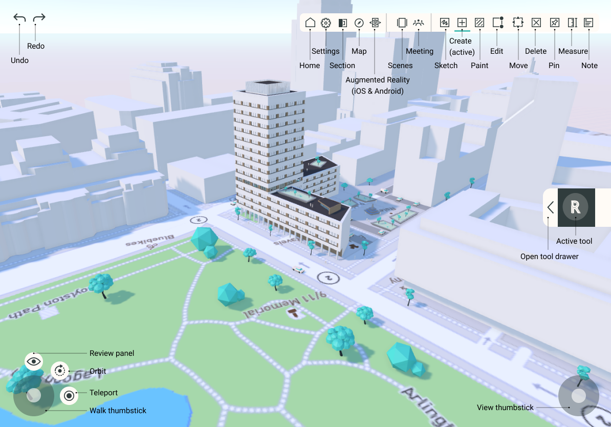

When you start Arkio in Windows/iOS/Android without VR headset the navigation tools are located in the bottom-left and right corners. The default tool when starting the app is the orbit tool in the bottom-left corner.

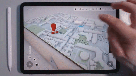

Panning and zooming in Arkio can be done using your scroll wheel on a mouse or using a two-finger pinch gesture on the model on mobile touchscreen devices.
When the orbit tool is selected in the bottom-left corner you can orbit around the model freely by touching/clicking anywhere on the screen and dragging the model around. If the orbit tool is not selected you can also orbit around the model by tapping/clicking outside the model and the green worktable and dragging your finger or mouse.

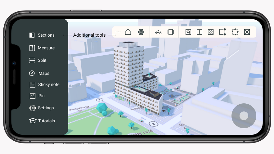

Using tools

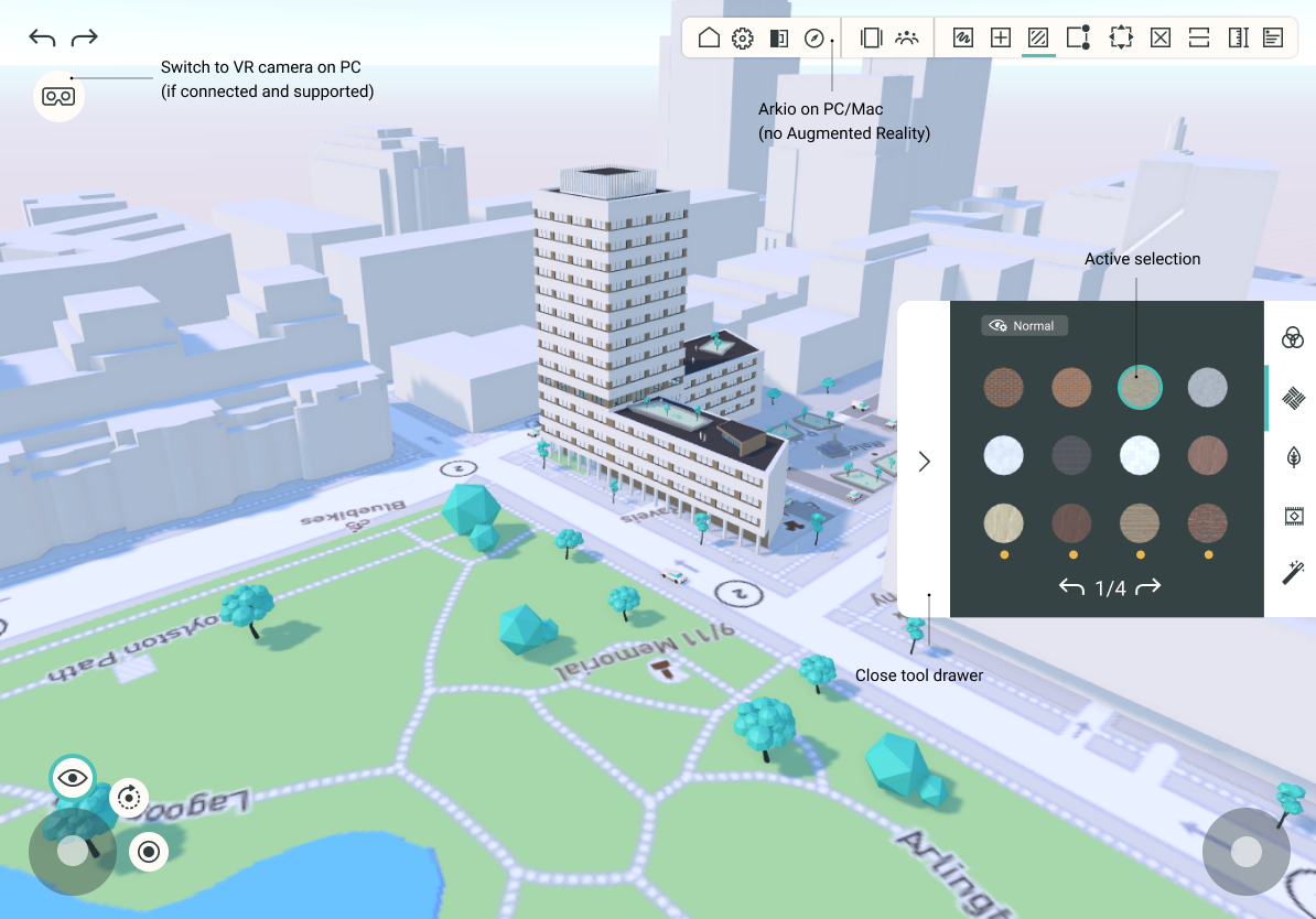

Tools are activated in Arkio by clicking on the top toolbar buttons, the active tool will be highlighted and additional tool options may be shown on the right side of your screen. This right menu can sometimes be expanded for more options like selecting other colors or shapes/assets to create.

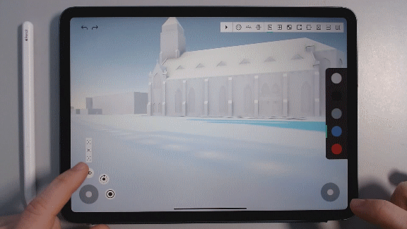

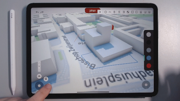

Tools like Create or Sketch require a drag motion while others like Paint require a single tap or click. The below example shows sketching on the model using the Sketch tool.
Some tools like the Create, Edit or Move work in three dimensions requiring toggling between working in a primary or secondary axis. While creating, moving or editing shapes you can briefly tap a second finger on your screen while still holding the first finger down to switch between axes.
