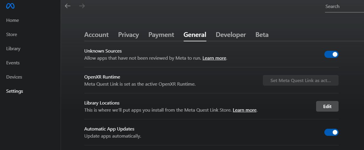

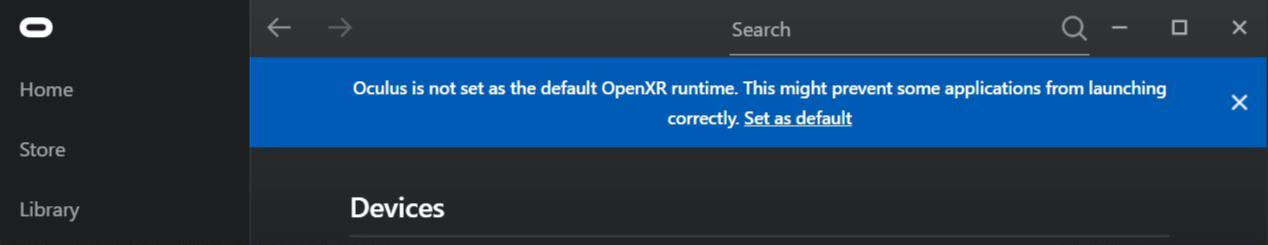

5. Running Arkio from our Windows installer will look for your OpenXR settings to start Arkio in the correct headset. Confirm your PC's default OpenXR runtime is set to your main headset. A notification should show in the Meta Quest Link or SteamVR app that helps you set this correctly. You can set this manually by going to Meta Quest Link > Settings > General
